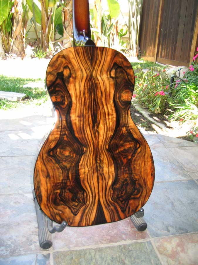

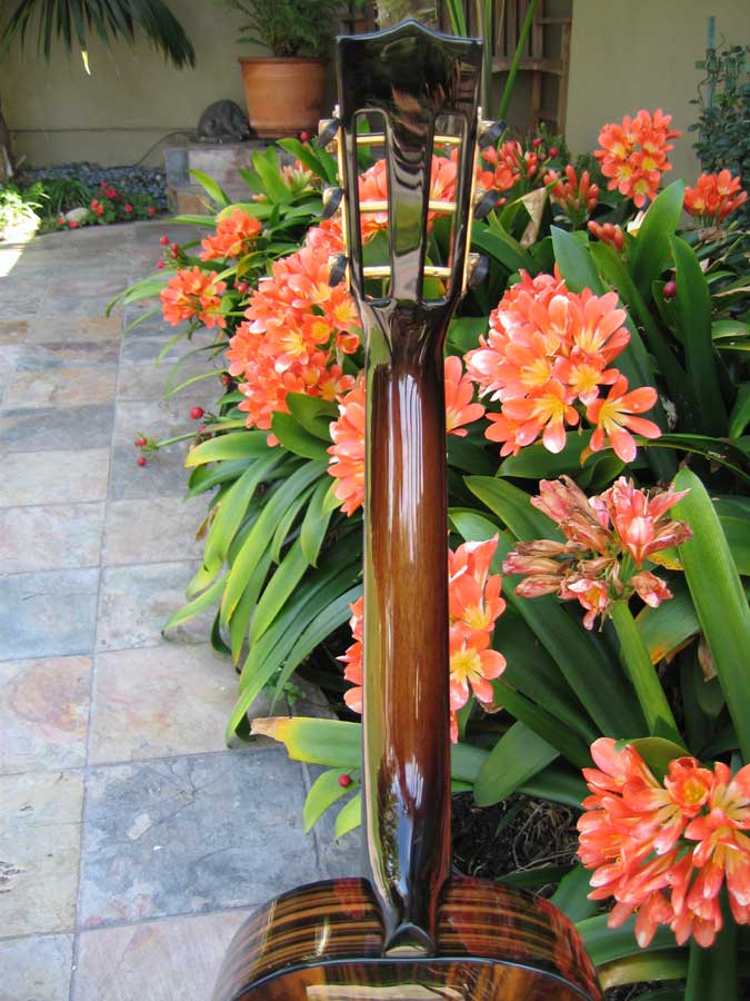

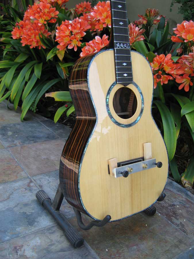

Well I have another to show you. This one is similar to a previous that I
showed all of you that I made for a collegue. The difference, this one is
MINE!!!!!!
I hate the rosette...WAY TO BIG..but it is what I had on hand.
The Specs.
0 Parlor 12 Fret 24.9 scale
Macassar Ebony Back and Sides
Port Orford Cedar Top.
I made this one to travel with.
We will see how it sounds...I like the warmth of cedar tops. I thought it
might help a bit on a small body guitar.

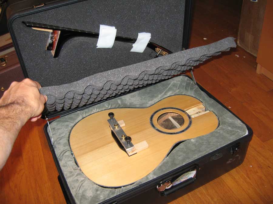

Forgot the best part. As I said, it is a travel guitar.
Here is the case. I just take it apart and roll it on the plane
No baggage monkeys to ruin it.

PostPosted: Sat Apr 01, 2006 6:55 am
Posts: 908
I agree about the size of the rosette. I think if you opened up the soundhole to within 1/8" of the rosette, it wouldn't look so out of place. You can cut a piece of black construction paper to see what it would look like, before cutting the top <g>
Less is more...
Otherwise, very nice!

PostPosted: Sat Apr 01, 2006 7:03 am
Andy, that's sweet. Is the case home made?
PostPosted: Sat Apr 01, 2006 7:06 am
I ordered the case from a company that makes cases for electronic
equipment. I just cut out the foam and lined it with some velour cloth

wow!!
That is a thing of beauty! I love the "eyes" that the ebony makes.
Great setup for a travel guitar. So how much time and effort does it take
to get thing up and running? Any thoughts on long term effects of not
having the tension of the strings on it in its disassembled state?
Fabulous work. Macassar is quickly becoming my favorite wood. I've
never played it or built with it, but aesthetically, its got a hold on me...
PostPosted: Sat Apr 01, 2006 8:07 am
Andy...Good concept, great work! BTW, there's nothing wrong with a simple black/white/black purfling sandwich as a rosette. Looks elegant, and it's easy to roll your own!
PostPosted: Sat Apr 01, 2006 8:12 am
Evan
I plan on keeping it set up all the time. Only take it apart for travel. Set up
should only take about 5-10 minutes. Bolt the neck on...both tenons six
bolts...2 in neck, 4 on the fretboard extension. Then string it up.
I don't plan on removing the strings completely. Loosen them up, velco/
wind them up. Leave attached at the headstock. Just remove the bridge
pins.
Carlton, I totally agree on the rosette. Simpler would have been MUCH
better

Beautiful guitar Andy. Great looking set of Macassar too. What's the finish? Nitro? Looks awesome.

PostPosted: Sat Apr 01, 2006 9:48 am
Bob
The finish is Cat Urethane....Tony did it for me... He is just awesome

Andy, that's one really sweet guitar. I like the case too. Sort of reminds me of Maxwell Smart and his "having gadgets in things that shouldn't have gadgets in them" kind of thing. (Phone in shoe, etc).

Nice flowers, Dr. Zimmer.
Really like the guitar, too. That is one sweet piece of wood.

Andy, your guitar is stunning, absolutely stunning!! And the neck idea, is well, crazy, I love it... That is such a great idea. By the way, nice clivias in the background!!
